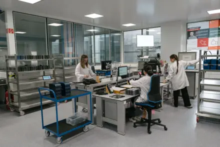

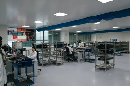

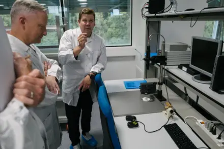

Entry to the hermetically sealed lab is via a double airlocked chamber, lab coats and shoe covers are compulsory. Except for specific high and low temperature rooms the entire lab is keep at constant temperature (23 degrees Celcius) and humidity. Should a power failure occur, emergency systems provide hours of back-up power. Even the separate room where air conditioning units, heating, power, servers and air filtering are located is spotlessly clean and laid out with clinical precision. Only in Switzerland would you find a boiler room clean enough to conduct human surgery.
As you would expect, the process whereby timekeeping is independently validated is itself an operation which seems to run like clockwork. The laboratory is an exercise in pure functionality. There is no decoration or any attempt to create a trendy, modern ‘campus’ like workspace. Workers process calibres with an efficiency and fast paced workflow: no wonder, they need to test thousands individual movements here every day. Testing runs 350 days per year only pausing for Christmas and scheduled maintenance. Different teams work at weekends (the ultimate student job?)

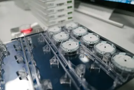

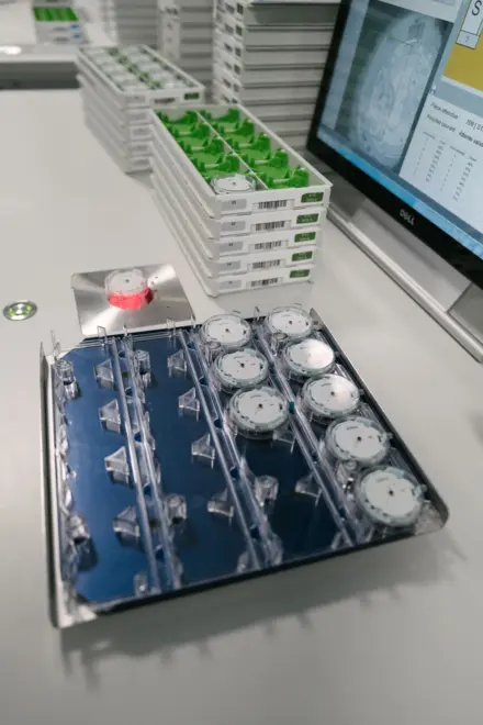

The test itself sees uncased mechanical movements without automatic rotors wound and run for 15 days. Special calibrated white COSC dials are fitted allowing calibration to take place. Testing includes running the calibre in five different physical positions and at three different temperatures: 8°, 23° & 38° Celsius (quartz movements are submitted to different test criteria). Watches transferring to the upper and lower temperature ranges must pass through additional double air locked rooms: a direct change in temperature would cause humidity to build up inside the calibre which could later lead to corrosion.

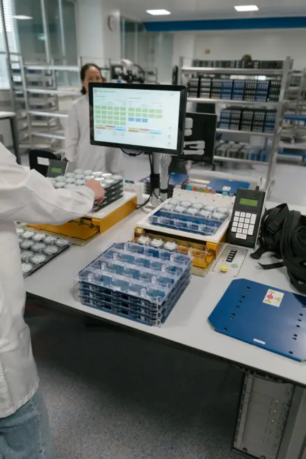

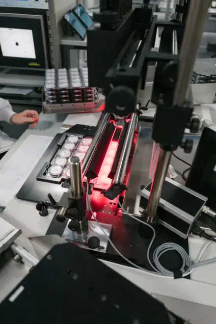

To complete a very slow test at a very rapid pace COSC has developed its own machines to process, wind and measure accuracy. After each movement is individually checked in calibres are positioned in special COSC designed cases, 15 pieces in each tray. COSC has developed a special winding machine which can deliver a full wind to any mechanical movement in a matter of seconds.

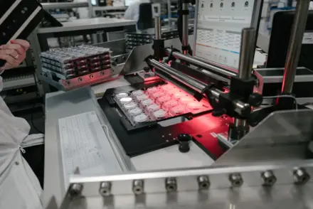

How is accuracy measured: using cameras, in-house developed software and plenty of mathematics. COSC measures the angles of the hands optically and their software can measure any deviation in timekeeping. Three atomic clocks are used to deliver the ‘correct’ time for referencing. Before the advent of digital cameras analogue films, prints and scanning were used to provide a similar albeit very manual process.
