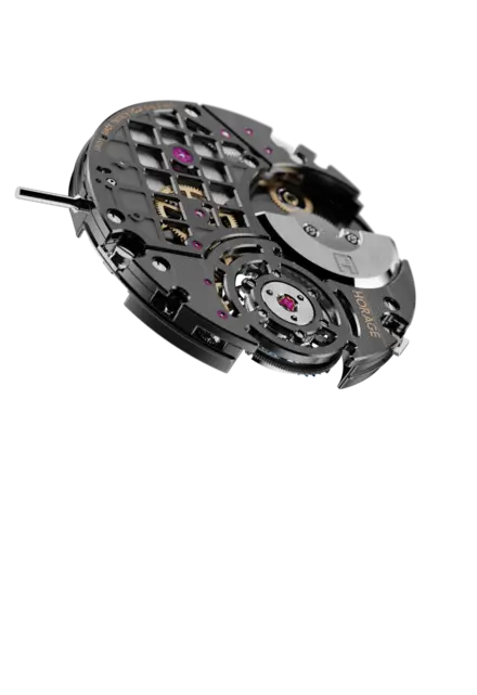

The journey towards the Autark Tourbillon started at the heart of the watch. The K-TMR movement was engineered, developed, tested and delivered within just 18 months.
RAISING THE BAR

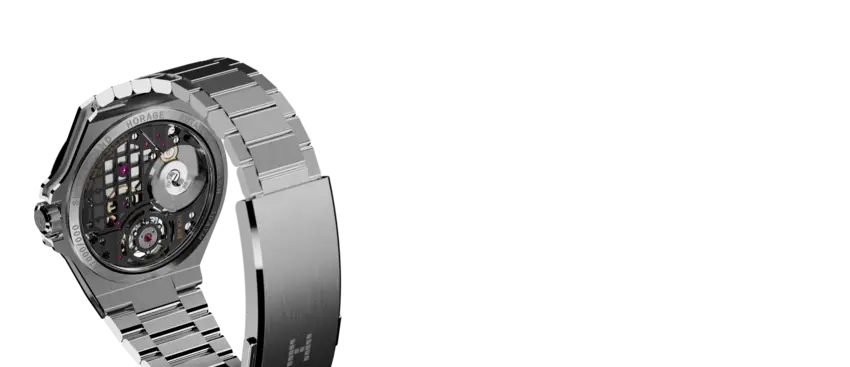

At 3.6mm the K-TMR calibre is svelte yet powerful, with 72 hours power reserve.
Through advanced gear train geometries, a full non-magnetic silicon escapement and optimized micro-rotor weight, the K-TMR is not only the newest proprietary Swiss micro-rotor tourbillon but one of, if not the most efficient micro-rotor tourbillon calibres available today.
To build the future you need to go above and beyond what is ‘normal’ today. Through advanced engineering, HORAGE has once again raised the industry bar and has placed the K-TMR in a league of its own for many years to come.
RHODIUM PLATED TUNGSTEN OR PT950 PLATINUM
Rewinding efficiency is at the core of any micro-rotor movement development.
Maximum rewinding efficiency is critical and the HORAGE engineers have used a Rhodium-Plated Tungsten micro-rotor for this task.You can choose to upgrade to PT950 platinum for an upcharge at point of order.
Tungsten is a dense metal and is the industry option for micro-rotors. Increased material density causes the rotor to swing and initiate the rewinding of the mainspring at lower angles.
This means smaller wrist movements will cause the rotor to oscillate and thus rewind your watches power reserve faster. The PT950 Platinum upgrade offers an even higher level of density. A premium precious metal option, which further increases the winding efficiency by an astonishing 8%.

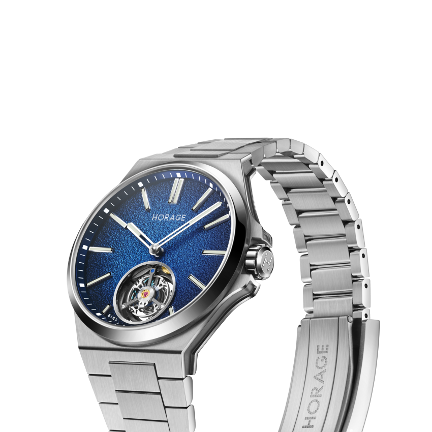

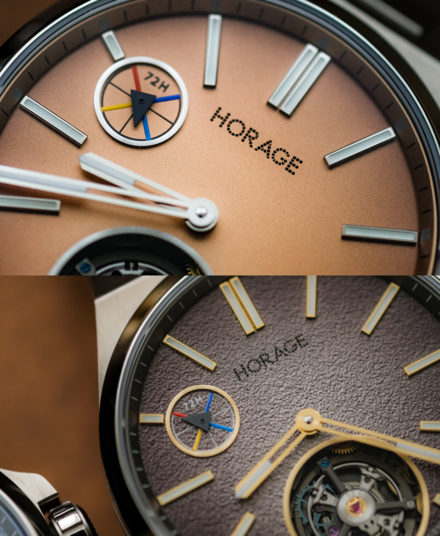

Sporty, mesmerizing depth was a prime focal point for the Autark Tourbillon dial.
Setting the mood to the functions and finish of the micro-rotor tourbillon are the choice of different dials. Stamped Gradient Grey, Sunray Black, Galactic Blue and Salmon.

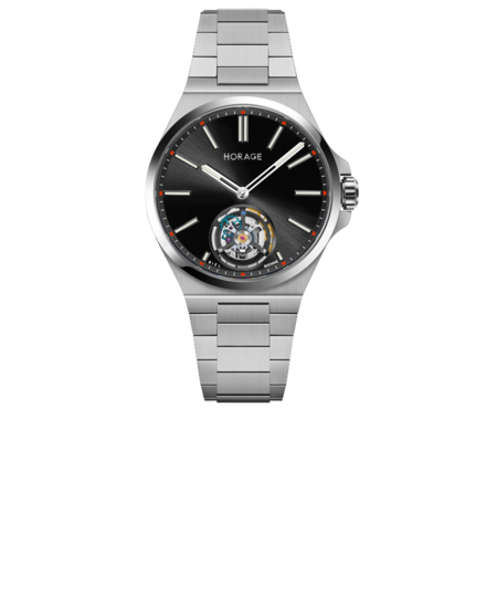

At 6 o ‘clock the 0.29-gram titanium flying tourbillon whirls and captivates as it makes a full rotation every 60 seconds. A blued screw in the cage references the seconds and can be marked at the 30-second point of the minutes track that circumnavigates the dial.
Champagne gold or bright rhodium finishing on the tourbillon cage aperture create a visual separation that complements the hour markers, which are filled with Swiss Super LumiNova®.
At 10 o ‘clock on the Gradient Grey and Salmon dials a power reserve indicator rounds out the chic technical finish of Autark Tourbillon.

Autark Tourbillon

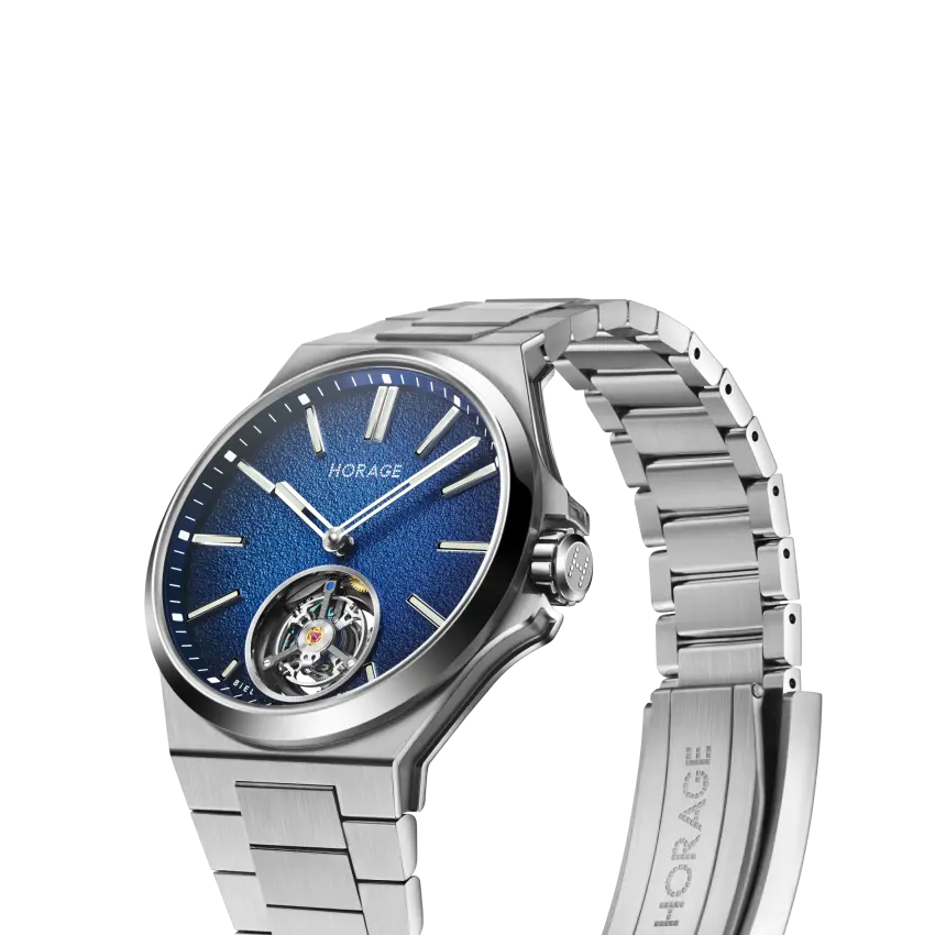

Galactic Blue

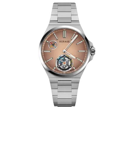

Salmon Dial With Power Reserve

Sunray Black Dial

Movement: K-TMR micro-rotor tourbillon, 3.6mm x 30mm, 72-hour power reserve, silicon spring & escapement, screw balance regulation, hand-finished bridge work.
