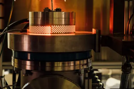

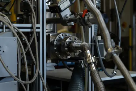

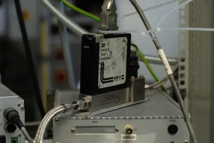

The CVD process takes a flat diamond ‘seed’ and builds layers of latticed carbon atoms by breaking down hydrocarbon gases (typically methane gas and hydrogen). This occurs in a special vacuum chamber and requires very high temperatures up to 1000° Celsius. At this temperature the hydrocarbon gases turn into plasma and slowly deposit pure carbon onto the ‘seed’. Diamonds created by CVD are cubic and have a neutral, clear colour range.
